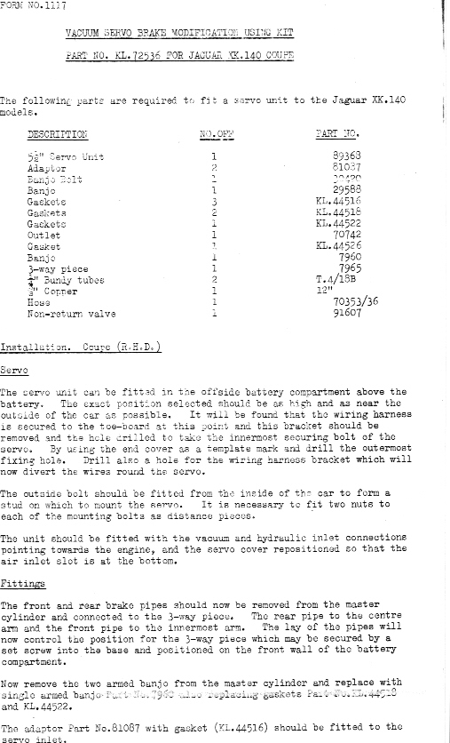

Here you go--Join JCNA and enjoy more! Submitted by SE98-32482CJ on Wed, 04/07/2010 - 15:35 Xk140 booster kit This is the sheet that was with the kit. The only thing the bulletin gives you that is not here is that a 'mud" shield had to be fabricated for the OTS and DHC cars. JCNA will offer more of this type of information in the future. Join now! Log in or register to post comments
