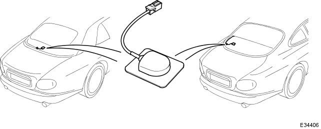

Can anyone tell me where the Navigation System GPS Antenna is located?
The workshop manual says, "The global positioning system (GPS) antenna is connected to the DVD reader by a co-axial cable, the inner conductor of which carries a 5 vdc power supply. The antenna is secured to the rear parcel shelf (coupe) or the convertible top stowage compartment by a self-adhesive coating on the base."
I have the convertible. I cannot see anything in the top stowage compartment, however, I did find a small, white, electrical connector in that location, left (driver) side.
Perhaps my antenna was removed by a previous owner.
Thanks in advance.
![](https://www.jcna.com/sites/default/files/42168163534528_1.jpg)
